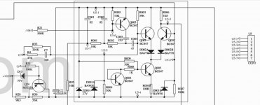

This is what I have drawn from your instruction, is it okay

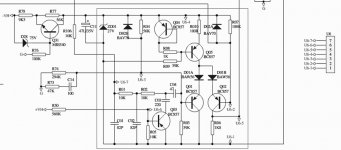

dorel
A little mistake.PWMNATD=pnp,PWMPATD=npn.

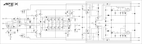

EMMANUEL100
When the amplifier is on and the is no input, how much voltage do you measure across the output transistors that are supplied by the down converter
dorel
Approx.7,5V. 2,5kw class TD.
